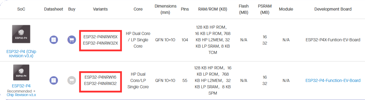

The expressions used in the title may seem exaggerated; however, the nature of the issues I encountered unfortunately makes such wording necessary. The first issue I would like to report appears on the product page where ESP32-P4 SoC devices are listed together with other ESP32 SoCs.

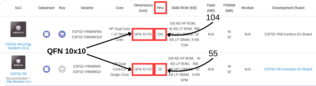

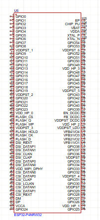

On the relevant page, there is a clear inconsistency in the section where the pin counts of the devices are specified (Image‑1). Although the chips share the same package size (Image‑3) and even the same underlying platform, the pin counts are listed as follows:
ESP32-P4NRW16 and ESP32-P4NRW32 models: 55 pins (likely referring only to the GPIO count),
ESP32-P4NRW16X and ESP32-P4NRW32X models: 104 pins (likely all pins excluding the exposed pad surface).
However, no such significant change or correction is mentioned in the revision reports. Additionally, within the EasyEDA design tool, the ESP32-P4NRW32 device (as shown in Image‑2) appears as a 104‑pin component (105 pads including the exposed pad). This suggests that the information presented on the product page is either incorrect or, at minimum, inconsistent.
Although this may appear to be a minor detail, if I had not noticed this discrepancy, I would very likely have purchased an incorrect device revision containing issues that are critical for my application.

Re: Fatal Error Related To The ESP32-P4 Datasheet Link And Incorrect Pin Numbers On The Website
Thank you very much for your detailed feedback and for providing the supporting materials. We truly appreciate the time and care you took to report these issues.
1. Pin count inconsistency
The pin count inconsistency on the Product Overview page has now been corrected. For both ESP32-P4 chip revision v1.3 (NRND) and ESP32-P4 chip revision v3.x (recommended), the GPIO count is 55.
