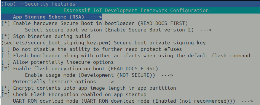

My WiFi and NVS related code:
esp_err_t bsp_nvs_flash_init() {
    esp_err_t err = nvs_flash_init();
    if (err == ESP_ERR_NVS_NO_FREE_PAGES || err == ESP_ERR_NVS_NEW_VERSION_FOUND) {
        // NVS partition was truncated and needs to be erased
        // Retry nvs_flash_init
        nvs_flash_erase();
    return err;
bsp_nvs_flash_init();
ESP_ERROR_CHECK(esp_netif_init());
esp_event_loop_create_default();
wifi_sta->netif = esp_netif_create_default_wifi_sta();
ESP_ERROR_CHECK(esp_wifi_init(&cfg));
Screenshot from 2026-06-16 08-42-37.png (74.42 KiB) Viewed 58 times
How should I fix NVS and Wi-Fi-related issues on devices with security enabled when migrating from 5.1 to 5.5?

Hi @dizcza ,
The IDF 5.2 has added one more indirection inside the nvs security. The concept is called nvs_security_provider.
The on-flash format is identical — read_security_cfg_flash_enc() in 5.2 ultimately calls the same nvs_flash_read_security_cfg() against the same nvs_keys partition. So if the 5.2 build is configured correctly (CONFIG_NVS_SEC_KEY_PROTECT_USING_FLASH_ENC=y, scheme registered), migration is seamless: the 5.1-written keys are read, the 5.1-encrypted NVS is decrypted, everything works.
The breakage is entirely in the new indirection layer:
In 5.1, key acquisition was unconditional and built into nvs_flash_init().
In 5.2, it depends on a separately-registered default scheme. When the project's sdkconfig is regenerated during the upgrade, the brand-new CONFIG_NVS_SEC_KEY_PROTECTION_SCHEME choice is resolved from Kconfig defaults. If CONFIG_NVS_SEC_KEY_PROTECT_USING_FLASH_ENC doesn't end up effectively set (its depends on SECURE_FLASH_ENC_ENABLED, or it lands on NONE), no scheme is registered → nvs_sec_default_scheme_cfg has null callbacks → nvs_flash_read_security_cfg_v2() returns 0x102 (ESP_ERR_INVALID_ARG) → the 5.2 "regenerate on any error" branch runs nvs_flash_generate_keys_v2(), which also returns 0x102 → nvs_flash_init() fails → Wi-Fi creds can't be read → the esp_netif_create_default_wifi_sta assert.
Please check the sdkconfig of your IDF 5.2 based upgrade and check presence and values of:
If these are not present, start menuconfig and navigate to "component config->NVS Security Provider" and set the Key protection scheme - to Using Flash Encryption. In order to see the settings, the flash encryption has to be enabled (this part is set in your project already)

Wow, thanks for the detailed route of where the error comes from and the steps I need to do. I didn't have the CONFIG_NVS_SEC_KEY_PROTECTION_SCHEME key in my menuconfig at all. I read the docs and added
REQUIRES nvs_sec_provider
After that, it's set to "Using Flash Encryption". And I guess the error should be resolved if I just reupload the OTA image with this flag enabled and call OTA update for my old v5.1 boards. I'll definitely try this once I have my boards with me.
Many thanks!
