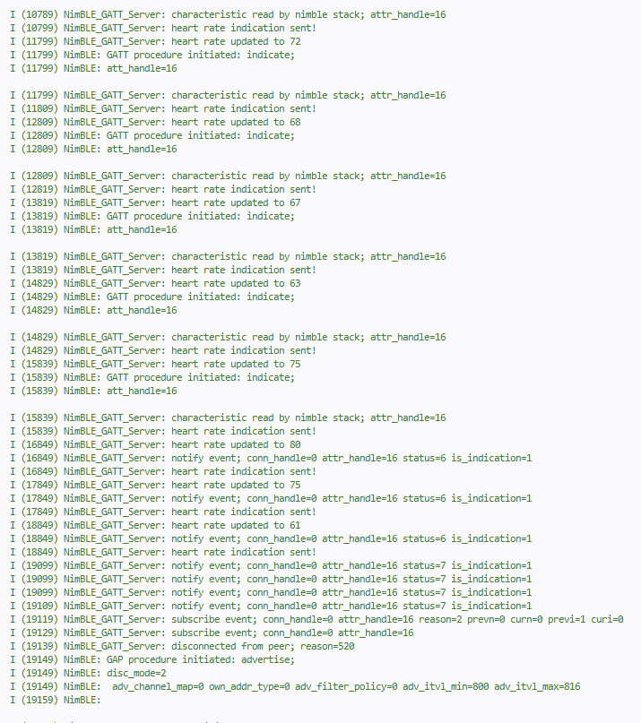

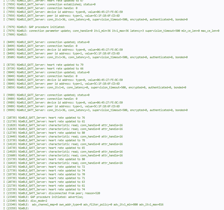

I am using the ble get started example from nimble named NimBLE_gatt_server(raw code) it connects with my using the app nrf connect but when i read write or subscribe at every 4 to 8 read or 4 to 8 write same for subscribe it gets automatically disconnected and if i again try to reconnect without manually resetting the control it do not connect.
logs when the code is running and it gets disconnected
subscribe .png (98.19 KiB) Viewed 16 times

Error code 520 implies Connection Timeout indicating link supervision timeout or syncronization timeout. Is this issue seen with only one device ? Can you switch the phone to some other device and check ?
What happens if you use nimble's bleprph/ blecent example, do they work ?
