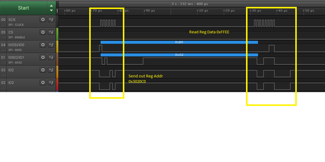

Hi all,
I try to use VSPI in QSPI mode to increase communication speed.
ESP32 can write out register address, but when it reads back register data, IO2 bit is always read as 0 although it is 1 in a probed waveform.
Here is my code to configure VSPI in QSPI mode:

The register addr is 0x3020C0 and the expected register data is 0xFFEE. However, ESP32 reads back as 0xBBAA ( all IO2 bits are read as 0). If IO2 bits are read as 1 then, it will return 0xFFEE which is expected.
I capture the waveform to check, IO2 bits are correctly output by slave device, but ESP32 always read as 0s.
I attach the waveform here. Note that in reading reg data phase, it reads 4 bytes but uses last 2 bytes (that requirement comes from the slave device.
Here is the print log from ESP32 showing that it reads back reg data as 0xBBAA
I (2183) GPU: Send 30,20,c0[3020c0]
I (2183) GPU: Rd16=aa,0,aa,bb
E (2183) FT8XX: Failed to check REG_PLAYBACK_FREQ[bbaa]
Should I miss anything? Is there any bugs in SPI driver in QSPI mode?
Please help.
Thanks,
Huy

- QSPI_waveform.png (38.49 KiB) Viewed 11323 times
