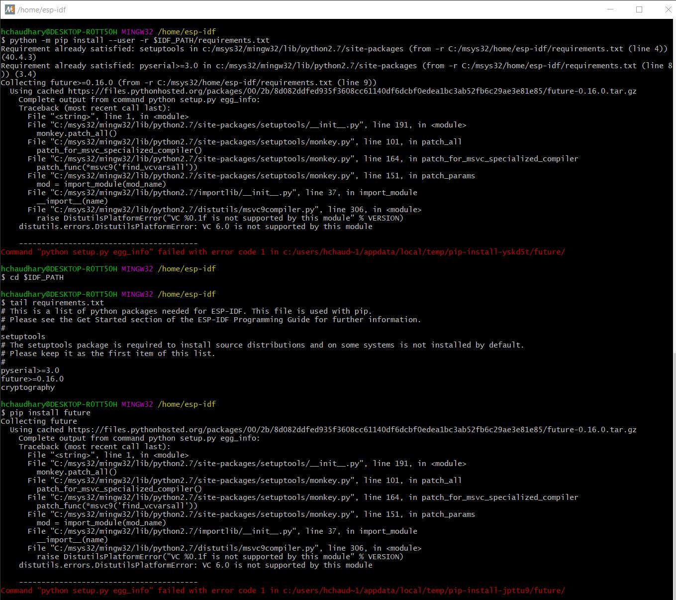

Fresh install of msys32 toolchain on windows
commit: 66fd7e9cc3d5327d94b5bf681100d1e3f2cf73e1
I am unable to install PIP "future" or "cryptography"
already ran:
pip install --upgrade setuptools
python -m pip install --upgrade pip
See attached pic.
Any tips?
File "C:/msys32/mingw32/lib/python2.7/distutils/msvc9compiler.py", line 306, in <module>
        raise DistutilsPlatformError("VC %0.1f is not supported by this module" % VERSION)
    distutils.errors.DistutilsPlatformError: VC 6.0 is not supported by this module
Complete output from command python setup.py egg_info:
        No working compiler found, or bogus compiler options passed to
        the compiler from Python's standard "distutils" module.  See
        the error messages above.  Likely, the problem is not related
        to CFFI but generic to the setup.py of any Python package that
        tries to compile C code.  (Hints: on OS/X 10.8, for errors about
        -mno-fused-madd see http://stackoverflow.com/questions/22313407/
        Otherwise, see https://wiki.python.org/moin/CompLangPython or
        the IRC channel #python on irc.freenode.net.)

Hi hassan,
Thanks for raising this. I thought Python would use the prebuilt library in this case, but it seems to be trying to compile one.
Solution is to run this command:
pacman -S mingw-w64-i686-python2-cryptography
Then re-running "pip install -r requirements.txt" will succeed.
Will update the docs and the MSYS2 environment to include this.

Postby hassan789 » Wed Sep 26, 2018 3:59 pm
Awesome, that did the trick.

I've run all the commands that you suggested:
python -m pip install --upgrade setuptools
But after that, when I run:
python -m pip install --user -r D:/esp-idf/requirements.txt
I got a following error:
Command "python setup.py egg_info" failed with error code 1 in c:\users\011lab\appdata\local\temp\pip-install-fxrkmd\future\
What can I do to overcome this error?
Thank you in advance.
Angus
Posts: 2344
Re: Unable to install PIP future or cryptography on msys32 for windows
Postby Angus » Mon Oct 01, 2018 5:23 am
Turns out that setuptools has to be installed from MSYS2, not pip. To fix the install, run the two commands mentioned here:
https://github.com/espressif/esp-idf/is ... -425790054
A new MSYS2 image without these problems will be available ASAP.

Try these commands in this order:
python -m pip uninstall -y setuptools
pacman -S mingw-w64-i686-python2-setuptools mingw-w64-i686-python2-cryptography
python -m pip install -r $IDF_PATH/requirements.txt
(You might get an error from the first command, if setuptools is not installed via pip. As you haven't provided any details, I don't know which error you're getting.)
Alternatively, you can download a newer version of the MSYS2 .zip from here and it should "just work":
https://docs.espressif.com/projects/esp ... hain-setup
