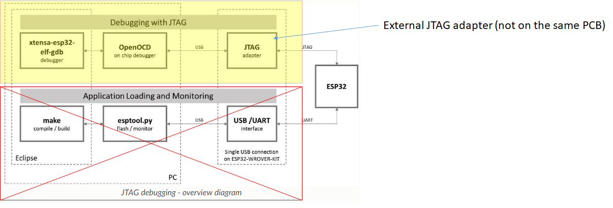

I got confused with the image below in the link on JTAG Documentation: https://docs.espressif.com/projects/esp ... w-it-works
JTAG Adapter.png (117.17 KiB) Viewed 21798 times
I do not have space on the board to add in the FTDI chip. I would like to use an external JTAG Adapter instead (and do not add in the UART interface) to program and debug both the MCU (STM32F446RE) and the Wi-Fi module.
In particular, by only having the section highlighted in yellow, is it possible to have the programming and debugging capability.
