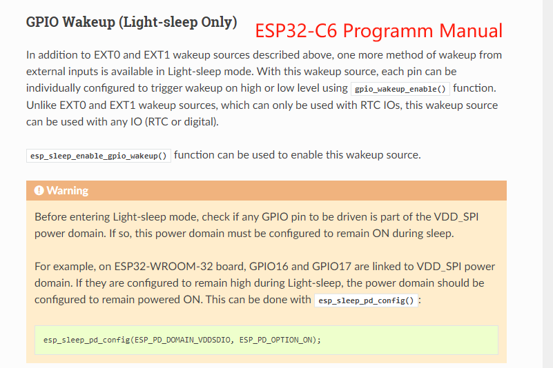

I have a question about the GPIO wake up in the ESP32-C6 chip.
I used to have a ESP32-C3, which uses esp_deep_sleep_enable_gpio_wakeup() to enable certain GPIOs to wake up deep sleep.
But after checking the ESP32-C6 manual, I found that GPIOs can only wake up light sleep. Is esp_deep_sleep_enable_gpio_wakeup() removed in C6?
ESP32-C6 sleep manual:
https://docs.espressif.com/projects/esp ... modes.html
ESP32-C3 sleep manual:
Could anyone confirm this? Any suggestion would be greatly appreciated.

Not the answer you might be looking for, but I'm using esp_sleep_enable_ext1_wakeup() and that works fine on the C6.

Thanks but I still want to use GPIO to wake up DeepSleep.
I noticed that External Wakeup can be used to wake DeepSleep with RTC GPIO, but I didn't find any description on the web about which pin of the ESP32 C6 can be multiplexed as RTC GPIO.
Can you make a suggestion?
The code reference only describe the API, but not mentioned about physical pins:
https://docs.espressif.com/projects/esp ... /gpio.html
Posts: 10636
Re: Can ESP32-C6 use GPIO to wake up Deep Sleep?
Postby Sprite » Fri Mar 22, 2024 11:46 am
See the datasheet, section 2.3.2. Long story short: GPIO0 to GPIO7 are RTC (LP) GPIOs.
