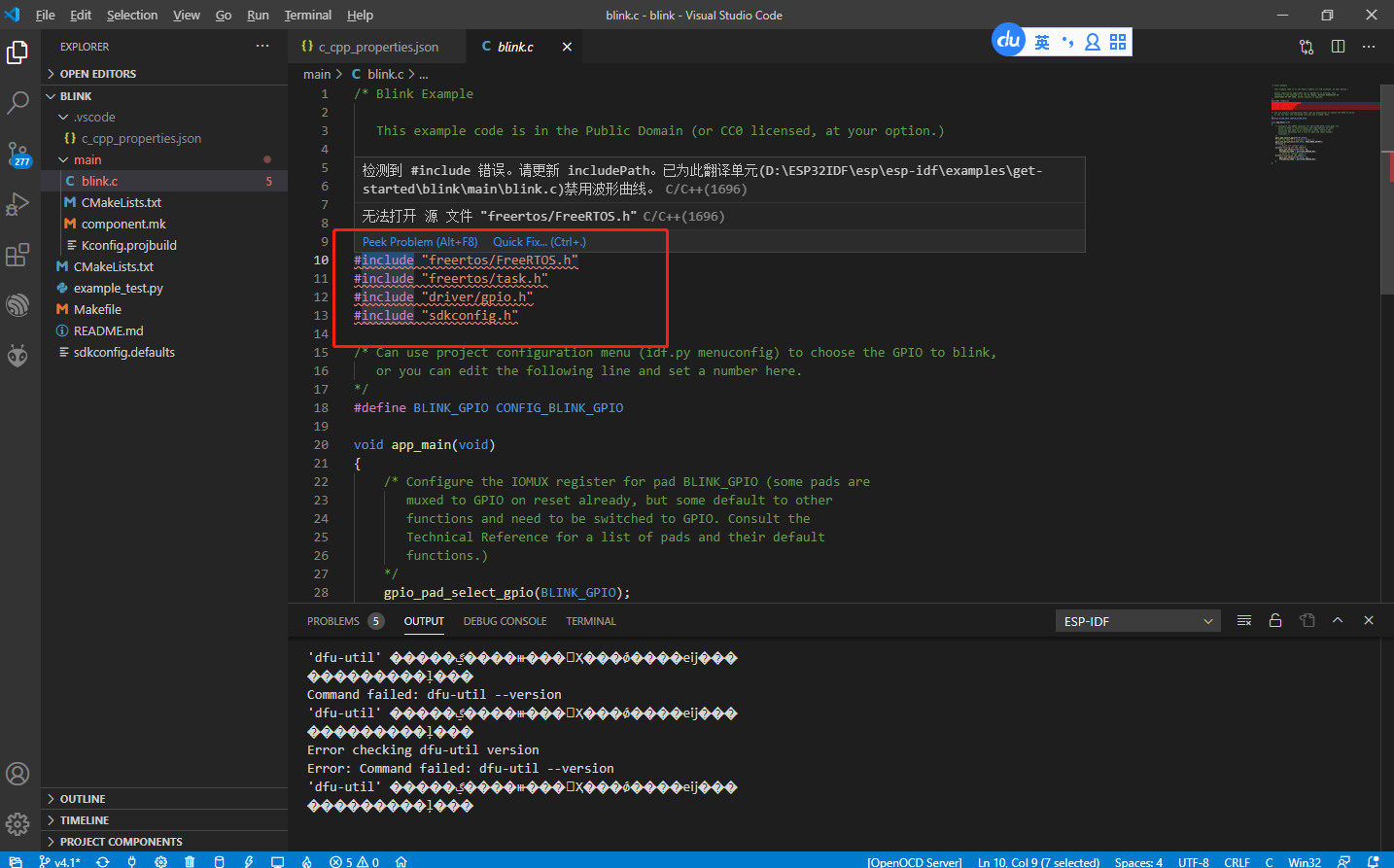

How to fix "include path " problems in VS code IDE?
Postby Pony Ma » Mon Jan 11, 2021 8:57 am
When started up with Visual Studio Code , This problem happened.
Thanks for help...

Re: How to fix "include path " problems in VS code IDE?
Postby TinkerBearNZ » Tue Jan 12, 2021 1:34 am
Do you have the C/C++ Extension installed?
I'm struggling to remember what I did to fix this, but I believe it's a matter of letting or making the C/C++ extension use build/compile_commands.json to find the proper include path.
compile_commands.json is available after you've done your first build.
Postby abansal22 » Tue Jan 12, 2021 7:41 am
These combination of the extension version works for me.
c/c++ ver 1.1.3
Espressif idf 0.5.1
Also to get rid of the error lines, you need to build the project first. Only after that vscode will be able to find the headers. Thanks!
Postby atemiz » Sun Apr 03, 2022 12:23 pm
Add compile_commands.json to your c_cpp_properties.json
"compileCommands": "${workspaceFolder}/build/compile_commands.json"

Postby medley56 » Mon May 05, 2025 5:09 pm
I think since v5.0 when they moved to CMake, these instructions need updating. Or possibly the C/C++ VSCode extension changed its configuration. Regardless, this worked for me:
In the C/C++ extension settings in the section for Intellisense, update the value for
"C_Cpp.default.compileCommands": [
As mentioned elsewhere, this won't work until you've successfully compiled the project and the json file is in the build directory.
