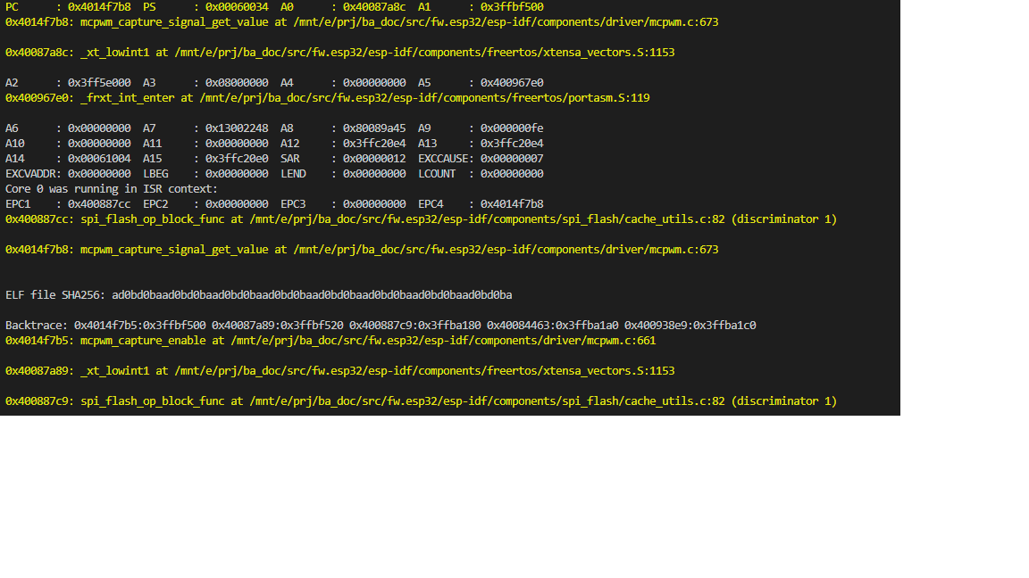

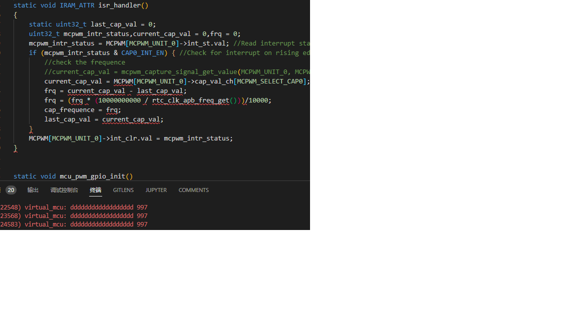

another question about the capture, see the picture for more details.
1.
how can i fix this issue with picture 1
2.
and i don't know the means about the value 10000,10000000000, this is from the example code.
i want to calculate the frequence about the input signal. i need the max value of the timer count and the clock frequence.
1.
2.

when i call the api(current_cap_val = mcpwm_capture_signal_get_value(MCPWM_UNIT_0, MCPWM_SELECT_CAP0);) from the capture interrupt function, thie issue will appear by high frequence.

i have find the reason of the interrupt error.
and i don't call the api from the flash this issue can be fixed.such like this picture ...

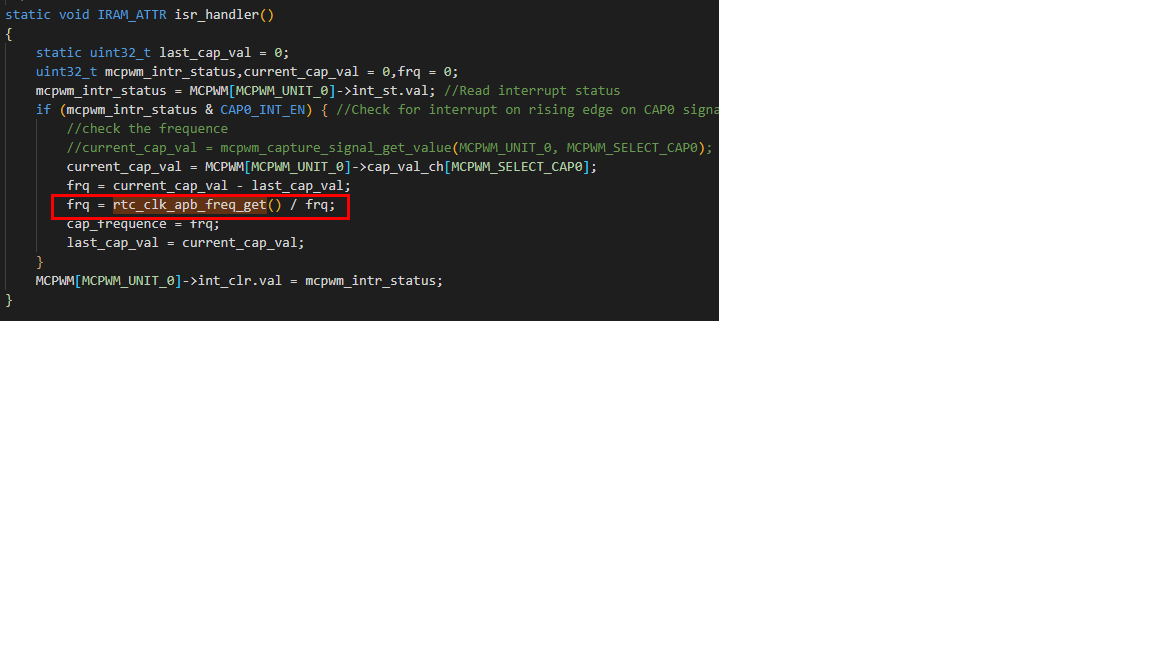

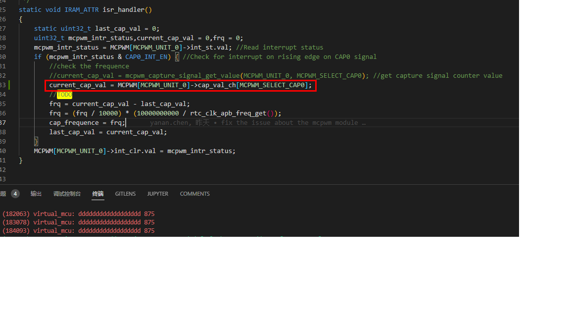

just for the calculation of the frequency, the input signal is 1kHz but we can see the result is 875 form the terminal log. so there is something wrong with this formula.
- cap fix.png (38.89 KiB) Viewed 3753 times

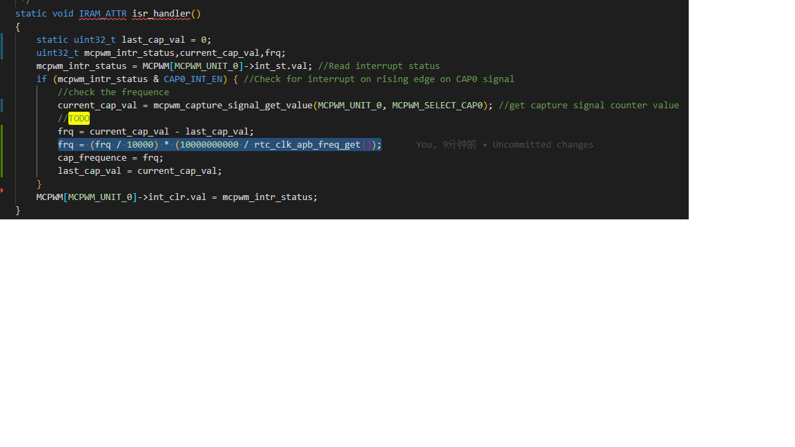

clock is the apb clock,and there is no prescale.
so the input frequency is apb_clk/Δ.
test is ok for 1k,500Hz and so on.
