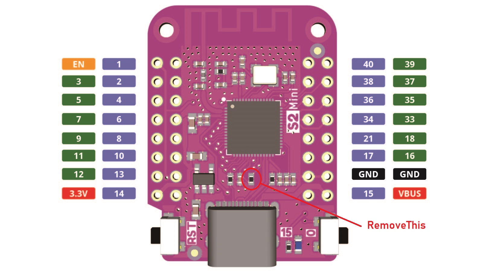

the documentation says that this pin is pulled up to 3v3 via 10K resistor, if I want to use this DAC output does that mean I have to remove the shield and remove R11 first?
The problem I see is that DAC 2 is stuck at 2.68V while DAC 1 just works fine.

Same issue. Why is there a 10k to vcc? To keep rx1 up?
Removing this should help: https://imgur.com/a/4MqclGo
